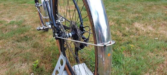

With it being a gravel bike I've not got the brake bolt to hang guards off - but I have seen this on another bike - this could work from what I see in the picture ?

That rack has extended mounts so the stays clear the rear disk.

The one in that picture requires a hole on the fork - but you said you don't have that - presume you have disk brakes. Probably better off looking at clip on mtb type guards that would fit a 29er bike. The problem with a close fitting guard as in pic is that it will clog with mud very quickly

It's not going to get used very much on the mud in the winter. A few trails maybe but most of it is road riding so the close fitting mudguards would probably do ?
You can use a plastic spacer above the rear guard to set the correct clearance.
At the fork, if you dont have a hole through the crown there may be a threaded hole at the bottom of the steerer. If the steerer is open at the bottom you can put a compression plug to mount the guard.
Always use QR mudguard mounts at the front for safety.

I've seen threaded inserts on the underside of fork crowns. Maybe you have one of those and will be able to fit a bolt up through a front mudguard?

A standard mudguard fitting would be a bolt hole on the rear side of the fork crown, but many carbon forks don't have any mounting points at the fork crown at all, or an opening into the lower end of the steerer tube.
However, it is often possible to use zip ties, by making small holes in the mudguard to thread them through
You'd want to remove the official fork crown fitting, and maybe add a bit of something between the mudguard and the fork, but it does hole pretty solidly.
