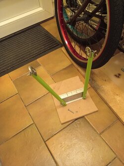

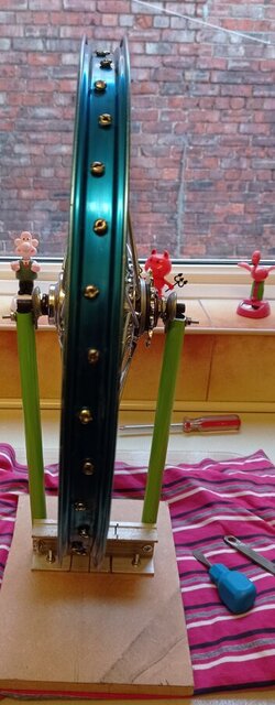

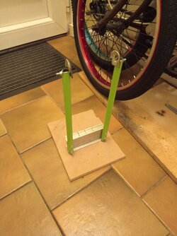

Hmm.... To 'elaborate on a challenge encountered, during the build, with illustration'.
To begin with, I know nothing of bikes...
I'm an engineering fitter, so, can sketch up/fabricate/modify some items, to achieve my goals.
I discovered, when reading about the Kingpin (on this forum) that 'the bean counters' had reduced the spoke count [... long ago] from 36 to 28. Consequently, 28 spoke wheels were subject to collapse 😡.
Worried about this (my being a stout, 'Lardy' guy) I searched eBay to source Kingpin 36 spoke rear wheel. Unsurprisingly without success!
I decided to build a 36spoke SturmeyArcher 'from scratch' >>> No Pressure 😱.
I got all the components, some new [spokes] some s/h [rim & hub], from eBay. The spoke spanner I made myself!
Plenty of 'how to' wheel build YouTubes, but I had no special set-up for building & trueing a wheel assembly.
The YouTubers gave tips and hints and suggested using your own bikes forks as a handy 'set up' option, my bike lives in the back of our kitchen and wasn't something I could wrestle with easily.
I decided to build a lightweight, easily handled 'fork frame' >>> using MDF, alloy bracket and cut down gazebo poles πŸ‘
My spokes were too thick for the alloy BMX rim and SA hub..... I drilled them out to suit.
I really enjoyed building the wheel, spent an hour tweaking out 'eccentricity/wobble' and my frame was superb, see pictures showing it opened up so I could secure the spindle = saved cutting fork slots!
I have no fear of a wheel collapse and my being pitched under a bus....
Thanks for looking.

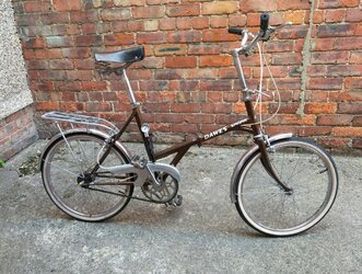

in the second picture it looks like there is too much stem showing.

I assume those are the normal Weinmann brake calipers with some kind of dropper plate so they can reach the 406 rims?
I went the other way on mine - from 440 steel to 451 alloy rims and, like you, it was my first wheel build and it all went pleasingly well. Alloy rims and dual-pivot brake up-front and it stops with the best of them now!
LardAbove
LardAbove
Tyneside
Yes.... Stem exposure is 'extreme' but it is actually a suck & see exercise >>> I'm trial riding at various heights (no less than 2 1/2" in clamp) because if I decide on "nose bleed" high I shall purchase Apes πŸ˜‰πŸ‘. The stem is a length of S/S 22.2mm tube [off eBay].
LardAbove 🚴
D
Deleted member 1258
LardAbove 🚴
Is there a minimum insertion mark on the stem? how close are you to it? I had a Kingpin in the early 1960's and broke the stem due to having it too high.
