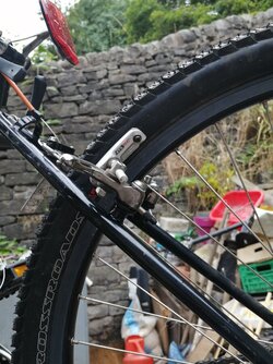

I decided to give my brilliant Rudge Bi-frame (folding ATB) a stripdown and rebuild. Took the rather crappy steel cantis off to replace with some V brakes and STI shifters in my spares tin.
The studs are really badly misaligned!
I don't recall any accidents and there's no paint damage that is discernible. I think I haven't noticed as the brakes worked OK. I have done a few thousand miles on them without issue.
What to do? I realise I could build it back up with the original cantis. I am reluctant to try to get new ones brazed on as I don't know how to strip the paint around the concentric seat tubes. The bike is a bit of a ten-footer and I don't want to pay somewhere to do it.
Just stick the old cantis back on? Hub gear with a drum brake? Or even an old school BMX type caliper?

If the brake worked ok before, try putting the V brakes on and see if they line up. I know it's a bit trial and error, but you never know.

I assume you realise canti and V brakes require different levers as they have different pull ratio's.

I did have different brake levers in mind but it's a moot point. I fitted an old set of STX-RC cantis I was saving for a new tourer and they have sufficient adjustment to both hit the rims. I am going to set them up and not worry.
