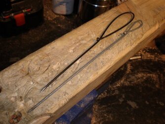

Some of the most useful cycle specific tools of all can be made at home. Indeed my favourite one cannot be purchased, so if you want one you're gonna have to make it.
The Jibber.
The Jibber begins life as a spoke - stainless ideally, though any sort will do. A Jibber made from a used spoke is every bit as useful as a new one.
Bend the head end around and over itself as in the picture so that the elbow engages to form a rudimentary handle. Add a little kink to bring the handle in line with the business end. Now file the threaded end into a point.
Use it to open up and pre-form the nylon sleeve within the ends of freshly cut cable housing.
Credit for naming the Jibber must go to Giles 'Giler' Meaden off of Bracknell Cycles.

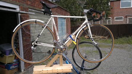

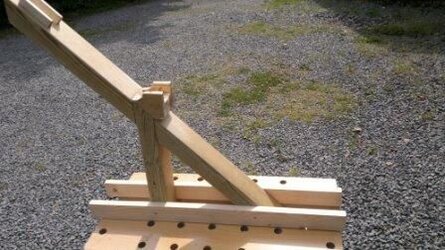

So far I've made a bottom bracket facing tool, chain whip, tool for fitting crown races, tool for fitting star fangled nuts, wheel truing stand, rudimentary workshop stand...................mmmmmmmmmmm what next :whistle:

I have made a workstand...but made it to fit in a workmate but then it became a bit bulky. The stand itself was ok, should have made it with legs. No loss...its all interesting.
I have a tool for the same job - it's known as a broddler and comes from rug / taprestry making :biggrin:
It's just a wooden handle with a pointy bit for making holes in canvas to stitch. Also used in saddlery for the same reason. But very convenient for cable housings.
zigzag
small allen key can do the same (that's what i use)
