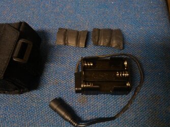

Let us know how you go on with the new battery. I've stopped using the 1st generation battery and made my own from 6xAA's - slightly less run time, but the pack should last longer overall.

Anyone interested in doing an AA based battery pack you will need:-
1 x 6 AA Battery Holder - Maplin HQ01B £1.19 (3 x 2 configuration in series) - Gives you 7.2v from 6 rechargeables
Like this:-
1 x PP3 Connector - Maplin NE19V £0.99 - this is for the rigid connector that shields the pins completely
1 x Magicshine extension or splitter cable (to butcher)
Some electrical shrink wrap.
Basically all you need to do is join the magicshine connector to the PP3 cable, and and use the shrink wrap to seal it. The pack still fits inside the magicshine fabric case. To make the join, I twisted each cable together (no solder), shrink wrapped both cables to insulate, then added another two layers of shrink wrap to ensure a neat join.
The only issue I had at first is that one of the middle batteries can pop out slightly under road vibration, breaking the connection - so I use a 2 x small pieces of foam and a couple of elastic bands to secure the centre batteries before putting in the case. Run time depends upon what re-chargeables you use.
This gives you the option of a cheap spare pack

Finished Pack with photo (foam is used to retain middle batteries with elastic bands
