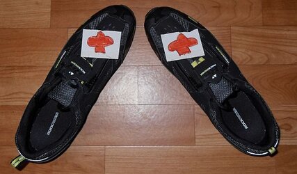

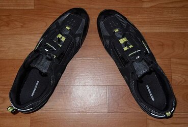

Should I try rotating them further (what direction?)
It really depends on what way your feet naturally turn. Check it out by sitting on a high table/kitchen bench etc letting your shoeless feet hang.
The angles in this example are extreme. Obviously everyone's feet are different.
If your feet naturally turn in like the shoes in "1 Cleats"
Then point your cleats towards your wee toes in "2 Cleats"
That way the cleat will be straight for 1 Cleats.jpg 2 Cleats.jpg 3 Cleats.jpg contact when you let your feet be natural over the pedals. "3 Cleats"
That way you won't be turning your knee on a plane it doesn't like by forcing your feet to be straight.
