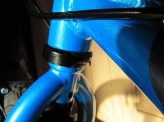

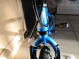

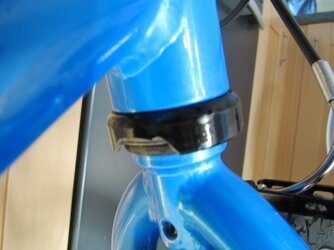

Last week I discovered a broken part on my son's Cnoc 16. Emailed them some picture's and apparently it's called a headset cup. They are sending out the new part and I can then take it along to my LBS to have fitted and then Islabikes will re-imburse the monies.
First of all, I have no idea how he could have broken this at the back, has not had any crash, there is no other damage in that area, or even a scratch. How on earth would a part like that just break off? Is this a part that's easy to damage? Or could it possibly be that it was maybe a faulty part that had already taken some stress before being fitted? I ask now as I am maybe a little worried that if it's the latter, then what else perhap's crept through on QC inspection and thinking I should get the whole bike serviced if that's the case.
Also, what would be the result of this breaking off entirely when cycling?

Ive never seen anything like that, I would say that has been struck by something. Have you left it somewhere
unattended could it be an act of vandlelism ?
The cup is there to seat the bearings and is pressed in place, the portion that is fractured does not in normal use suffer great stress. I dont think it could break off completly as the cap has quite a lengthy insert into the head tube. Biggest worry there is crap getting into the bearings causing accelerated wear IMO.

I suspect that it's had an un-noticed knock. It doesn't look like a manufacturing fault.

Not a place one would expect a knock when riding. How is it stored at home? On it's wheels? Hanging from a hook? Alone? With other stuff?
Islabikes are doing the right thing in sending out a new part and offering to pay for its replacement, especially when I doubt that it happened on their watch. I do not think you ought to push for a full service at their expense. A simple check, done by yourself, should reveal any further problems.

It's an alloy shield, looks as if it's designed to protect the bottom race from muck. From the way it has broken I would say someone has clouted it - maybe one of your son's pals dropped the bike or crashed on a test ride. These things happen; your lad is probably pooping himself. You can't blame Islabikes for that, some alloys are very brittle and will snap easily and that part wasn't manufactured by Islabikes. We have a Bheinn and it has been very robust over three years of knocks and abuse.

They are replacing the part - good customer service.
TBH it's a 'cheap' part so don't get too worried. As folk have said, it just holds the bearings and provides a seal against dirt. Easy to swap out.
