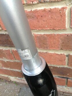

I am looking to sell these forks, and I am unsure if I should be advertising them as tapered.
The steerer is 1 1/8th as per normal, but then at the bottom the fork is wider - the wider section is not the crown race which can be seen at the bottom of the fork.
See attached photo - the wider section is just below the label

looks pretty much straight to me (ie same size the whole length of steerer)measure it prop with a caliper

Tapered steerers widen to 1½" dia at the bottom. The photo doesn't look it does
