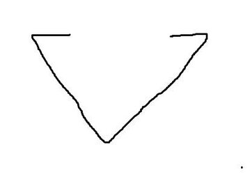

Or if you want to make the tool you describe use a giant paperclip and bend into a U shape.
numbnuts
I made this out old a spoke, but any wire will do
