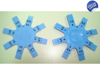

On occasions I have experienced problems because the spacing between two adjacent sprockets varies at different points around the circumferance of the sprockets. The best way to check this is with a gap guage like the one shown here:
Put the appropriate blade between the spockets, rotate the cassette or freewheel and see if it binds in any particular spot. The image is from a Chinese wholesaler web site and such guages are not common in cycling workshops. I think they are mostly sold as gap guages for welding. Doubtless some exist on eBay and Amazon: be sure to get the thicknesses correct — most such guages are for much smaller (sub-mm) gaps used in engine tuning.
On an old-style freewheel, one can just replace the distorted sprocket. Some of the more up-to-date cassettes may not be so easy to fix.
The problem usually occurred on larger sprockets subjected to unusual strains such as hitting a sudden brick wall slope round a blind bend when on tour and heavily loaded.
Just one of many possibilities; but if you do manage to find one of the guages they can come in useful for setting brakes, specifying chainwheel spacers and other adjustment problems.
