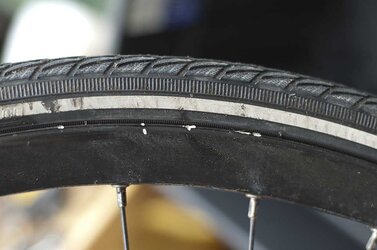

If you've got decent wheels I'd be far more worried about what your contact points can take... this is from a hitting a pot hole at over 30mph on a rigid frame with Halo Freedom 29er rims shod with 700x28c Schwalbe Marathon plus:
I've been munching ibuprofen on doctors orders since that encounter

Yeah it's not pleasant & my injuries were just from the impact of the pothole, I didn't even come off the bike! The rim it's self while not perfectly true didn't take more than mild tweaking with a spoke key to pull it back into shape (I'm suitably impressed by these rims & the quality of a factory built wheel).
