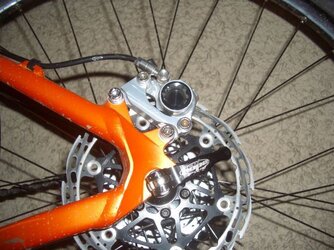

For a 160mm rear rotor you will need the Type F Hope adapter (adapter in your second link), the Type A (adapter in your first link) is IS to post mount 160 front, and 140 rear.
Have a look here at what Hope actually spec:
http://www.hopetech.com/page.aspx?itemid=SPG315&tab=specification
A picture of Hope Mono Mini Rear, 160mm rotor and Type F adapter
I hope this makes sense.

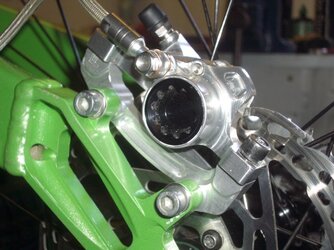

if its the right 1 m8, showed lbs this thread and he says that the type f aint right either, here are some pics and adapter in pic wont go whatsoever
i'm sick of this bike lol on holiday it is while i replace half of it haha
GilesM
East Lothian
The problem is that is an IS mount brake caliper, not a post mount, this is an older Hope design, and it would normally be fixed directly onto the rear IS mount on the frame with no adapter and a 140mm rotor, so you have two choices, fit it straight to the frame and use 140mm rotor, or get an adapter that is IS to IS spaced to fit the larger rotor, I'll look for he right bracket and get you pic in a short while.

still not right m8, thanks for all your help though, here is a pic of bike fitting
as you can see its a different attachment.

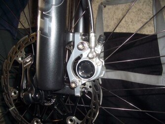

I undertsand now, the only thing that I can see from Hope that may work is one of these:
http://www.chainreactioncycles.com/Models.aspx?ModelID=13735
This is actually for the front fork post mount to IS caliper, it may fit your bike at the rear, and it lifts the caliper out to fit a 160mm on the front, apart form tat, the only suggestion would be to use a 140 rotor with the adapter you have, one of these would look pretty good:
http://www.chainreactioncycles.com/Models.aspx?ModelID=80548
I hope this helps.
Giles
GilesM
East Lothian
A picture of the adapter in the previous post, this obviously shows it on the front forkss of a bike.

even with a smaller rotor the universal mount wont fir anyways, got the above and heres the problem
1st way:
2nd way:
there a few mm to high to grip full rotor edge which could cause few problems with pads and evening them out so back to square 1
