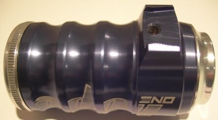

Incidentally, the rubber seal on mine overhangs the front block and and means it partially sits in thin air and must be making a difference. Makes me wonder if the position of the hole is too far forward
Do you know if yours is similar?

The O ring desn't overhng on mine but the hole is in the same place as yours
