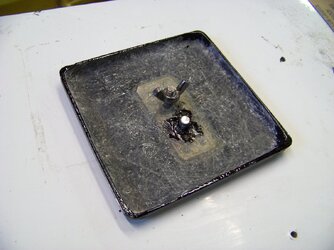

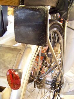

A mount to fit on my Tortec rear carrier, on which I'll stick a 'speed camera' yellow/black sign - hopefully this will minimise the harassment/close passes.

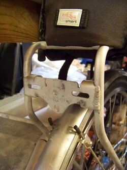

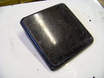

Made with a strip of Stainless steel onto which i welded a 6mm screw and the shank of a 6mm bolt (to locate on lower hole of carrier). The heads of the screw and bolt were then 95% removed. This strip (with multiple drillings to aid adhesion), was embedded in the laminate of resin and matting I laid up in a 'lego' surround on a bit of board, radiused with plasticene. GRP is good fun to work with (nitrile gloved essential though)
