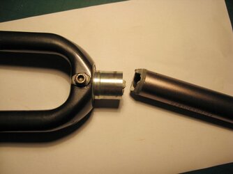

Hi, I'm new to this forum and looking for advice. I'm a keen lifetime cyclist and I'm trying to help my friend who had a severe accident when the fork steerer tube snapped on his hybrid bike (made by a very large bike company, that I don't really want to name). He lost consciousness and arrived in hospital having lost a tooth, fractured his cheekbone and cut his face and arm badly. It now also looks as if he will lose two other front teeth.
There was no one else involved in the accident, the forks broke (on a two year old bike) whilst cycling at a moderate speed on a flat road in East London. It's always been serviced by the shop it was bought from, has been kept indoors and has never been cycled more than 10miles from his home in London.
Too see what happened to the fork - see attached image, quite scary.

Russell Jones and Walker are the lawyers the CTC use. Your friend does not need to be a CTC member to use them. My b-i-l used them is his case and they were superb though his was a deal more open and shut than your friend's.
EDIT: and that is a truly scary picture. Was the steered bonded somehow into the 'race' machined part of the fork. The break appears to be inside that section.

I would have thought it would need a thorough investigation and possible product recall as that looks like it could be a design or fabrication fault which could apply to other bikes.

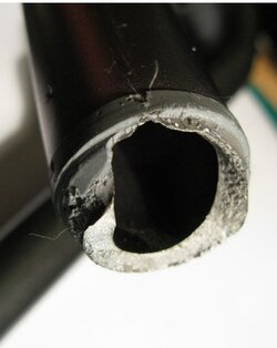

These are the two images I have that show the each side of the break. The steerer tube appears to have been bonded into the shinier metal sleeve (that is in turn bonded to the fork crown) with a plug or join of mouldable alloy of some sort, this is what fractured. Looks like a fairly pointless bit of (value?) engineering to me? I'm used to mountain bike forks where sensible alloy tubes bond straight into alloy fork crowns. fork crown-low-res.jpg
