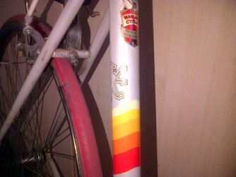

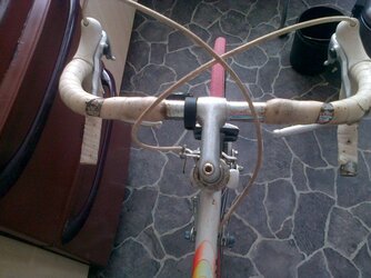

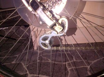

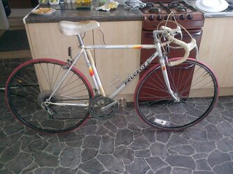

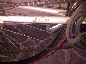

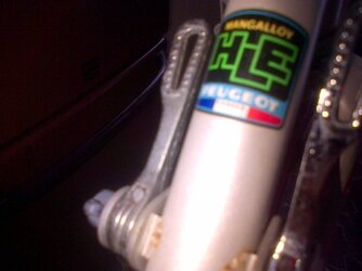

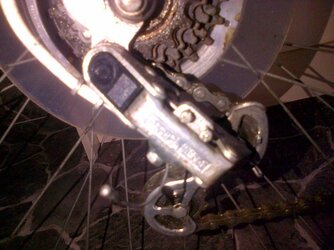

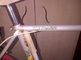

Hi guys, not sure if this is the right area so apologies if it isn't!
Ive recently acquired this bike and knowing nothing about them was looking for some advice, as you can see the saddle is well past its best as is the bar tape which looks like it needs replacing. everything else works really well and I rode it 6 miles home yesterday when I bought it.
Gears change well and very little noise from them, brake blocks on the back need changing but ive got some spares.
Wanted abit of advice an what bar tape to replace the old with and how best to clean the old girl up!
Cheers

Any bar tape you fancy will suffice TBH.
Baby wipes are great for all round cleaning, and metal polish will shine up the, er, metal bits.
Personally I'd strip it down to bare frame, clean everything up nice and bonny and rebuild it greasing accordingly as you go.
These old bikes can be a pain to work on if you get seized threads etc, but a bit of patience and some penetrating fluid usually does the trick.
You might find the seatpost is seized in, but fingers crossed it's not as that can be a total b@stard to sort out.
FYI, I'd keep any spend low as these were a low end bike in their day and won't be worth much even minted up, but cleaned up sympathetically they make great run arounds.
Be warned though, the resto bug can be very addictive, and can easily become a costly process, just trust me on that one ;)

Cheers smokey.
Id like to try replace the saddle like for like (ish) I know bar tape doesn't cost a great deal and as I paid £15 for her in the first place I don't mind spending a little bit bringing her back to something like former (non)glory!

Congrats on getting the bike. It is budget model but should give sterling service. It is about twenty years old. Probably just needs some basic maintainance. Check the spokes, are they tight and do the rims run true? I suspect they are chrome so be aware they won't work in the wet! Special blocks will sort that. Check the BB for wear by wiggling the cranks from side to side, just slight movement is OK. Also check the head bearings by holding the front brake on and pushing back and forth. Might be worth buying some cone spanners and re greasing the bearings in the hubs. Hope you are a practical person! The frame looks in good condition so just clean it with T cut or similar. As for bar tape just get a good one that takes your fancy. If you are interested check out mytenspeeds.com for some info on restoring old pugs. Good luck.
I'd like to try replace the saddle like for like (ish) I know bar tape doesn't cost a great deal and as I paid £15 for her in the first place I don't mind spending a little bit bringing her back to something like former (non)glory!
You could try a wanted as in the classifieds HERE. I'm sure someone will have something similar lying around, whether or not they can remember/find it is another matter.
Or ebay can be good for older bike parts as well. There's usually someone selling an older part after replacing it with a newer one, just got to keep checking and keep your eyes peeled.

Thanks for the advice Cycleops, I might just give mytenspeeds a look. im not so bad with the two roadies ive got now but they are both under 3 years old, not sure why this just seems abit daunting! no idea about the running gear etc. im sure ill find out along the way.
Didn't pay much for her and as shes worth nowt im not too scared of messing up! time to get dirty!!! ^_^
