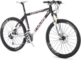

If it helps I used to have a 2008 Focus Raven Expert, and I'm sure it had the same fork in white.
apparently those came with fox forks?!
Perhaps they changed at some point during manufacture, but mine came brand new from Wiggle with Rockshox, just not absolutely sure they were Reba's, but they looked identical to yours just in white.
[EDIT] This has been bugging me like a bad itch! So I've trawled my hard drive and I've managed to find a pic of the Focus I had, and it actually had Rockshox Recon Race forks, my bad as I believe the kids say these days. Still not Fox though so not sure where that info came from?
