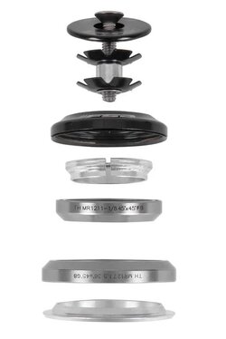

Headset dust cover not sitting on top of compression ring - as per photos

Difficult to see but is the black ring (with the lower lip) just below the dust cap, the compression ring? If it is then I think it may be upside down.

So the dust cover does sit into the bearings if I take the compression ring out as per above but that doesn't feel right to me
