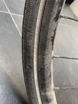

Picture of original tires and the pressure they recommend
And my electronic pump Electronic bike pump
I'll try to take a photo of the tire itself next ride.
Thanks for all the feedback!!!

I went to my excellent bike store :
Paris Bike shop
and they confirmed the tire indeed was underinflated.
This picture just after having used the digital pump and inflating "5 bars".
It seems as T4tomo suggested the digital pump or its gauge is kapput.
The bike shop inflated the tire and inspected it and said there was nothing wrong. I'll keep track of the tire but will now go back to a good old old-fashioned pump. No more gadgets.
Thank you all for your time and suggestions!
