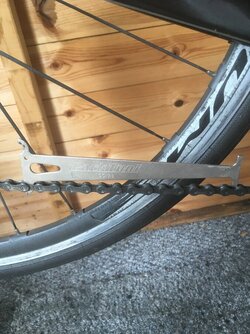

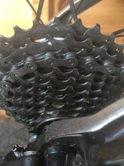

Here are some pictures of the chain with the wear check tool and the cassette.

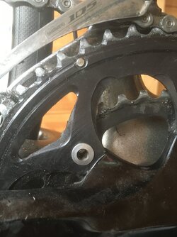

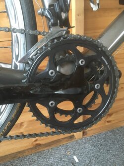

Yes you've posted some good pics of the Chain and Cassette could you post some up of the Chainwheels ? Though I'm sure that some more adjusting of the Rear derailleur could be perhaps fortuitous? do you experience the same faults when bike is in the work stand ?

11,000+ km is a great longevity for a cassette to have achieved. Very surprised the new chain didn't immediately skate on first use (and every high torque use/occasion) - maybe it did: the OP does not say/exclude.
Replace cassette and chain at your earliest convenience. The chain will be close to or beyond 0.5% elongated already. If just the cassette is replaced, the 'old' chain (1200km on it) will skate on the 'new' cassette.
No skating on the stand would be expected: you can't get anywhere near the power needed.

Could be sub-optimal indexing, but in view of the cassette age I think a new cassette & chain is probably sensible, even though on the face of it they don't appear to be in terrible condition.
