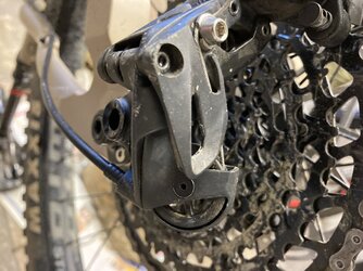

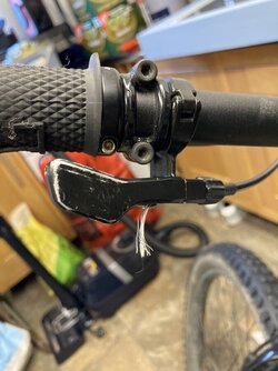

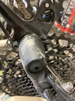

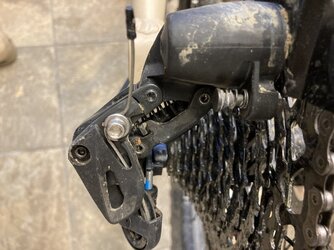

As you can see, the right hand screw (bike is upside down btw) is a long way out and the left hand one a long way in.
You can also see the allen nut on the cable but I can't see a barrel adjuster or similar.
I'm new to bike mechanics so simple instructions would be appreciated.
Thanks.

I'm not sure which screws you are referring to.
Regardless, two things to point out...
1) The cable tension can be adjusted at the lever with the adjuster circled in blue. Turn anticlockwise to increase tension. But...
2) There's a big problem - the frayed end circled in red should not be there. Rather the end of the cable has a neat grommet on the end which slots in to the adjuster. It's astonishing the gears work at all! You need a new cable.

Turns out that with the bike upside down I had photographed the wrong lever: that frayed cable is the end of the seat dropper post!!
Sorry about that.
However, there is an adjuster (identical to the one you have circled in blue) on the gear cable and turning this appears to have solved the problem (although I haven't riden it yet).
