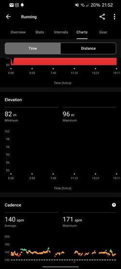

I use a Forerunner 55 to record rides and walks, which has been doing with no problems for some time.
I have just noticed that when I look at the activities on Garmin Connect only some have any data on the elevation graph, whereas lots are blank. This has only happened in the least few months.
Not essential but irritating!
Any clues why this has happened?

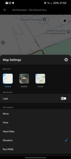

In your run/ride data using Garmin Connect try selecting "Change Elevation Source" as below.
