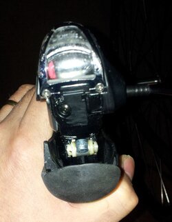

Have taken a couple of pics to show my predicament. The end of the cable has shifted to beyond the cover. Can I undo that cover for better access??

Hard to see from those photos but can see that you may have not fitted the correct brake cable - it looks like the one you have put in is thev-brake type with a barrel end. For STis you should have a pear shaped one. Can't really see what has happened to the gear cable but if it is pulled through you need to get it out somehow! To insert the gear cable you need to ensure the lever is in the small ring position before inserting it

Followed the advice given by all videos regarding what gear it should be in. I used the same type of cable for the rear mech and there is no issue.
I think its just come out of its slot. attached is the cables I use.

The cable is supposed to be in its slot but has moved and is now behind the plate. What is the plate for? can I remove it without effecting the shifters performance??

Got it sorted. I should say my help got it sorted!
Because the end of the cable was not in its correct position, it positioned itself just out of sight.
One person with a small screwdriver used as leverage to slightly lift the plate which the cable was under and with a small long nose pliers accesed the cable end and pulled through and removed.
It appears that when I put the in, I should have ensured the end of the cable was fitting in its slot and keeping the cable tensioned to ensure this. (better with 2 pairs of hands) Because I did not, the moment I pulled the cable it jammed in the mechanism.
