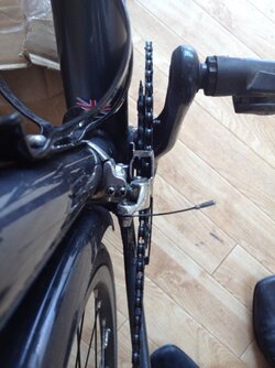

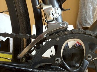

I'm concerned about the chain catching the mech though. I'll take and post a couple of snaps in case you can see anything that's not right.

Attached a side and top view below. I've shifted the mech so that it should be tying to change, but it's staying where it is. Any comments?
...apart from how filthy my drive train is.

If anything, the derailleur arm looks a bit high. As if its not catching enough of the chain to move it across. Don't know what other people think. Its frustrating not being able to see it working. But if its too high why is it only just started to play up? Is the derailleur mount bolted very tight on the frame or can the mount move? If everything is tight try a quick cable adjustment.

Ok.. so according to the video - just before 2mins 30 if it won't shift down then I have too much cable tension, and a loosening of the barrel adjuster should sort it out?
I'll obviously double check the positioning of the mount though too.
Pauluk
Leicester
Be careful, when you say loosening the barrel adjuster. If you turn it out (anti-clockwise) I think you may be increasing the cable tension as you are effectively increasing the distance/path length of the cable. If the adjuster is fully turned in then you will have to undo the cable at the derailleur to decrease the tension. Does this make sense?

Yep. That makes total sense. Clockwise on the barrel. If it wont budge then loosen the cable off from the mech a fraction. Cheers Paul
