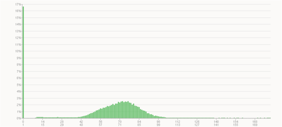

This is a chart of my cadence from January 2010 to the present day from WKO. As you can see it is around 16.5% where I am not turning the cranks. As for the actual distance and time spent, freeewheeling, I cannot see in WKO or Sportstracks at the moment, how to calculate it for a percentage of time and distance over a season for example, but I can find it out for individual rides. For example a very hilly 120 mile ride I did back in May in a total time of 7hrs 57mins, I free wheeled for 46.48 mins and a distance of 15.4 miles. Another ride on the flat of 86 miles which I did in 5hrs 5 mins, I free wheeled a distance of 2.69 miles with a time of 14.23 mins free wheeling. These figures are for a RPM of 0 - 1 rpm, but by the chart from WKO, I hardly pedal at all below 42rpm.

about time 15% "coasting" about 10% of the distance - and does it really matter - on the gym bike the target is the target - what is not the same is not the same
