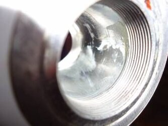

Anyway I have attached this photo to try and show you why I am perplexed on how to solve the problem. As you can see the thread is quite deep and if you look through the BB there is no lip for either the clip or bearing so it seems to me that this was only made to take an external bearing.
I have contacted both Wiggle and Focus to try and find the answer.

If you are talking about a standard 68mm English threaded Campag triple square tapered bb this should do the trick as explained here. It is press fit with loctite with no reliance on lip or circlip.

Thanks again but I cannot see how that is going to press into the screw threads and the Campag BB I brought to use threads in ok anyway.
