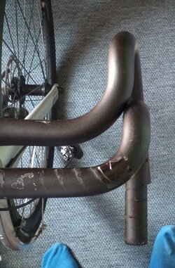

I ended up buying these exact bars - I went from 44cm bars to 40cm measured at the hoods and slightly wider than 44 at the end of the drops, most drops riding will still be within the 44cm zone though. A test ride showed that it didn't really feel too groundbreaking but I think that's a good thing, any narrower or a wider flare would have been too much for me. The hoods are angled in slightly but not that noticeably, except the lever throws on the drops seem closer and more accessible, which is nice. (the original bars may have been 44cm edge to edge rather than centre to centre, so the difference wasn't as much as expected but still feels like the right width regardless.
Almost incidentally, the different shape of the drops means my biggish hand fits in the front of them much more comfortably so I'll likely be using them much more.
Top bars are the Genetics, bottom are the original Boardman bars, socks are by Marks & Spencer.
