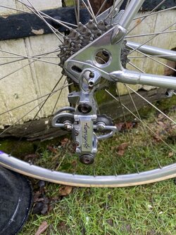

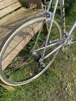

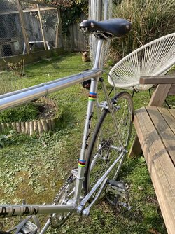

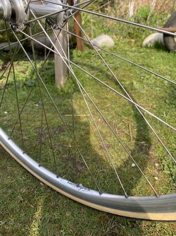

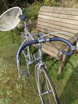

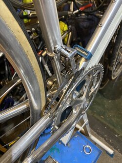

Having snapped two tyre levers, bruised the palm of my hand using the tyre levers and then puncturing two new inner tubes, is there an easier way of putting replacement tyres onto existing rims??:angry:
It was equally hard removing the old tyres although as I was replacing the amount of care was slightly less.
The wheels are Campagnolo on a 1980'a ALAN so nothing unusual.
Any short cuts or tricks of the trade greatly appreciated. New inner tubes ordered but awaiting for help before i ruin another set! :cry:

Nice bike

What rim tape are you using? Too thick a layer will make fitting a tyre more difficult. You need to push the bead into the centre of the rim as you work it on.
