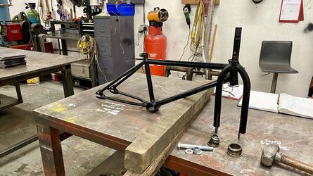

So: the hub of the build arrived today. A proper Old-School frame from 1983 or 1984 we think. To accept older: one-piece crank, 10mm axles and side pull brake calipers. Exactly what I’d have used when I started BMX’ing.
And this F+F IS representative of exactly the cheap, no Brand-name base I used then and wanted now. As this was what I genuinely started with - and put some nicer parts on: eventually upgrading to a much nicer F+F years down the line.
So the idea always was for this to be a true representation of. Not what exotica I had posters of on my wall, not the bike i lusted after; or the bike I so wished my not-rich Daddy would somehow buy me. No I’m making the actual bike I made my first cycling / BMX memories on. Pretty much…..
Anyway: after work I removed the forks, knocked out the bearing cups there and in the bottom bracket, cut off the chain guard tabs, and had to cut off original seat clamp as it had two tack welds on the inside.
Tomorrow Morning I can finish delicately smoothing off the welds from the above. Then decide on the finish. I know the colour I want. Just got to decide on an unbelievable quality and horrifically priced wet spray from my trusted sprayer. Or an ok quality (Will be a little ‘industrial’ ) but free PowderCoat finish through work. No middle ground is there !
Thanks for staying awake if you made it this far 👍

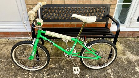

While I’m not very long into building retro BMX No1: I seem to have now purchased No2 🤷‍♂️
A 1983 Puch Invader that’s almost entirely original and incredible for its age. Bit of adjusting / greasing and mechanically it’s amazing. And still on (Presumed original) Kenda tyres, Lee Chi brake blocks, pad-set, reflectors, all decals blah blah. Literally needed minimal elbow grease and 2 new inner tubes - to now ride fantastically. Might just leave exactly as-is for a man-cave ornament…..
