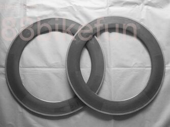

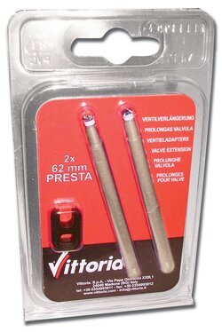

Almost all my 'tubes have removable cores & I've had very few problems with them, that said I do have a valve core spanner (you can see a cheap one in the valve extension pack pictured below). Those I have had problems with have been consistently bad even when using valve extensions so presume that there's a problem with the tube.
No idea why these completely stupid inner tubes with removable valves are sold but they're a nightmare.
so much better than valve extenders where you can't properly seal the valve shut (you're forever pumping the tyres up).
