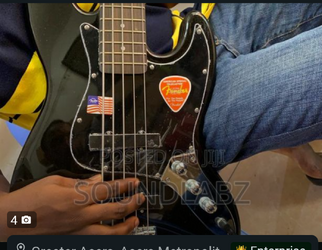

The trade in counterfeit goods worldwide is huge. Everything from car parts to designer clothes so why not bikes too?
Down here I see lots of fake Fender guitars which look very convincing even down to stickers proclaiming made in America.
