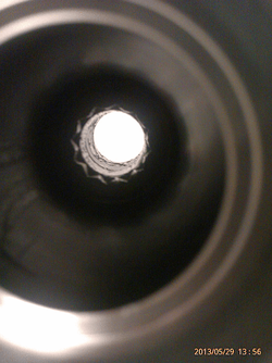

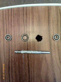

It seems I was wrong. At closer inspection there seems to be serrations inside the hub body, possibly for a hex key. I have tried various sizes and none fit (all too small, the largest being 10mm). I'm guessing I need a 12mm hex key. The rest of the workings are basic. An axle, a bearing either side, and a washer/seal. IMAG0504.png IMAG0505.png

It looks like a Shimano clone - undo the 12mm hex locknut and the freehub comes away.
Unfortunately that may not get you anywhere as the pawls are usually sealed inside the freehub so all you can do is squirt WD40 through any gaps that you see in the hope it does the trick (I presume the pawls are sticking and that is the reason for the service)..
Yep, that's right.
I remember Lennard Zinn mentioning not being able to get to the inner workings of hubs, if you wanted to regrease them, just as you say. I managed to find a 12mm hex key and also sprayed some WD40 in there, and then some light oil. Put it all back on the bike and it seems to have done the trick. Time will tell. Thanks again, Pete.
