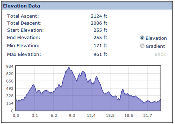

This one you dont need gps unit of any sort just use mapmyfitness draw your route and it tells you when you press the altitude or elevation.

Map My Fitness is the same as Map My Ride. I got on OK with Bikehike because you don't need to join. The eventual distance figure was two miles less than my bike computer measured so that's close enough for me over 55 miles.
