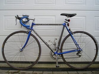

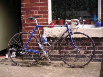

I'm using my old Dyna-Tech as a (all year round) work-bike/commuter/trainer
It's a 1994 model (bought new from Kendells in Castleford), & a 755Ti
Now, the point that's starting to cross my mind after 18 years is; how long will the bonded tubes/lugs last??
- Is there a life-expectancy to them, have I exceeded it?
- if so, will it give me warning (by creaking/'funny handling)
I'll be sad if it does, as it's the best handling bike I've ever ridden - even on the '20' section tyres that I have to use to get mudguards on it (the silly Salmon Profils)
Miscellania;
It's still on the original bottom-bracket (Campag Chorus) which although 'never touched', still spins totally freely without a chain.
Campag Chorus chainset is still unmarked, with all the laquer, despite winter riding
The hubs have been greased twice(?) - they're the original Ultegra, onto Mavic Open 4CD
However, the (8-speed) STI levers occasionally require a flush with WD40, as they get sticky & refuse to change to a higher gear
Ritchey stem & seat-pin are still unblemished (as per the chainset)

The early Dynatechs were affected by poor bonding because apparently the lug / tube clearances were too tight - there wasn't enough adhesive. The Special Products Division did sort this, but by then the Dynatech image had suffered.
Yours should be ok in this respect - however the Ti frames did have a reputation for cracking. I think some cracked around the bb area, and definitely around the downtube bosses. So much depends on the weight and strength of the rider and how many miles have been covered.
On a more positive note, I remember from the old Raleigh forum that some guys were using them regularly and had no problems at all. I have a steel Dynatech from 1991 and all the joints are perfect btw.
