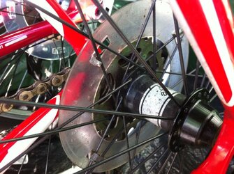

The clean plastic round thingy which I think protects the wheel side of my chain and chainset seems to have broken - one of the plastic clips has snapped.
Do I need this bit, will my chain be filthy without it or can I purchase a new one - and fit it myself?
Thanks!

No you dont need it, but make sure the rear mech is set right.
Profpointy
No you don't need it; bin it. I have never had one on any of my bikes
That said, you do need to be marginally more diligent in adjusting the gears so they don't jump off the inside end. That said, you'd be pretty unlucky if they actually go in the spokes

I'd agree, you don't need it. On the other hand, if you don't mind it being there, visually or whatever... it does provide just that bit more insurance that the chain won't mash the spokes if it happens to de-rail off of the largest sprocket. If the rear mech and shifters are correctly set up, the chance of the chain getting thrown towards the spokes is tiny - but it's still possible. I wonder if if it's ever happened in the Tour de France or similar? There's a subject.
