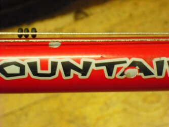

I recently bought a new bike and have decided to rebuild my old one from the frame up and use it as a spare. The frame seems absolutely fine structurally but 8 years of grease, gravel, grit salt and D-lock abuse have taken their toll on the paintwork:
So since I'm stripping it down anyway (getting the BB out this morning was fun!!) I thought I might as well repaint it for rust prevention and also so it looks shiny and new when I'm finished. I spoke to a guy in Halfords earlier and the only place he knew off that did resprays locally (St Albans) was somewhere in Sussex and the cost started at £140 + paint + courier charge. However he had recently sprayed his own frame and gave me some really helpful tips about how to go about it if I decided to do it myself.
So my question to people on here is: is it the kind of job that I could make a reasonable go off myself? I'm not fussed about having a shop quality finish, just something that looks alright and most importantly protects the frame.
