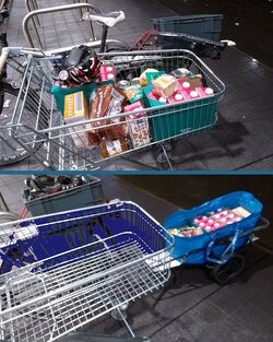

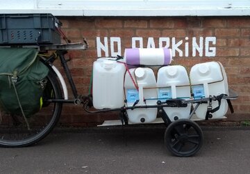

Whilst this trailer was created to satisfy a particular need - as outlined above - it obviously gets used for more 'normal' everyday trips - such as shopping - especially now, as we don't have a car.
We're lucky to live with both German discounters way less than 10mins away (one walking, other cycling).
The latter location is great for heavier loads as it's at the top of a hill.
Pic is of a typical recent visit - with all the heavier stuff carried in the trailer - 28Kg total.
Edit added a pic from today - 4 off 20L plastic containers used from a local shop that refills customer's containers. Excellent quality items, complete with breather vents, able to be stacked and destined for rainwater storage for mrsbtg's gardening use - otherwise gone to landfil? as the shop's supplier no longer wants returns - 6Kg

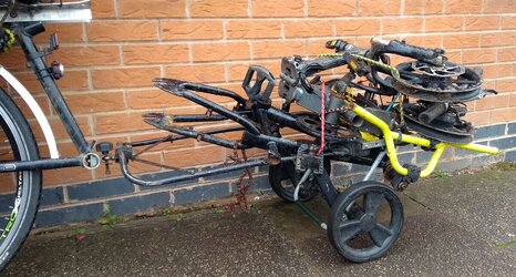

Example of a load that can be carried on the basic trailer frame, without employing any form of container.
Today I was part of a group litter picking in a local park. I personally only found boring detritus, but other individuals unearthed much more interesting specimens.
Since no one else wanted them, I brought some home.
Folding (Hybrid) Ebike
BMX frame
Small drone
Old video camera
Skateboard
Plastic storage crate - of a type I already use.
First two items on the trailer (22kg) rest on the bike.
