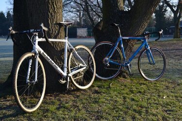

I've got two of those already
Unfortunately they are not legal to enter in MTB races :angry:
