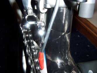

I own a Cube Agree GTC Race with a triple crankset set-up and after a chain derailment because of incorrect set-up the frame was quite badly damaged now i dont want to go into whose fault this was only to say that imo this frame/triple crankset combination should never be offered for sale untill some sort of anti-derailment device is fitted because if the chain comes off the inside chain ring it will serious damage the frame because of the oversized BB shell and its proximity to the small chain ring.
I would be interested to here from anyone with this bike(triple crankset only) whose chain has come off.
The same bike with a double or compact wont have the same problem as the clearance between frame and chainset is bigger.
