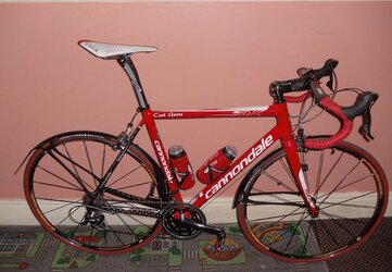

I have just fitted my Crud Racer Mk2 Mud Gaurds onto my Cannondale Six because the last time i tried to fit these the orignal 105 brakes wouldnt let them fit onto my bike , but now ive changed my brakes to Dura Ace this has giving me enough clearance to get these on :rolleyes:
But for some reason the back one is still catching a little bit and does anybody have any tips to stop this , ive have the little buffers on the correct place .
Will this damage my tyres or not ? as the wheel is moving fine ?
Image attached and thanks for your help

Sorry here is the image

Thanks for the reply i have more clearance than i did before that's why i refitted them :rolleyes:
does everything look normal for the image ive uploaded and ive been moving the bits around and i think that the noise could be coming from those buffers .

Sorry Carl, I was just staring at your bike, what was the question again? ;)
Nice bike - personalised signature on the frame too! I have an old CAAD 5 in red which I'm rather fond of.
It's almost impossible to tell much from the photo to be honest, other than that you seem to have lost the back of the front guard. Did you take it off because of 'toeclip overlap' or snap it off? I get some contact with the front of my shoes so I have to be careful, but it only ever happens if I start zigzagging up steep hills.
Thanks Colin i did the personalised signature myself and cost me £3.75 from e-bay and its on both sides :rolleyes:
The front mud gaurd snapped , infact that was the rear one on my otherbike and i put my bike upside-down and it snapped off . Im just waiting for my dad to drill me another hole and i can refit it .
Ive not had a problem at the moment with them catching on my size 51 shoes :laugh:
I went for a ride and the noise stopped and i think its just that little buffer on the side touching the wheel rim/tyre
But im glad its all sorted now and i can get out on my bike with the club runs now and get some training in for the time-trials this season :rolleyes:
