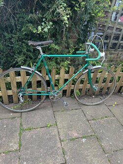

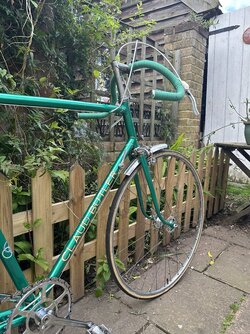

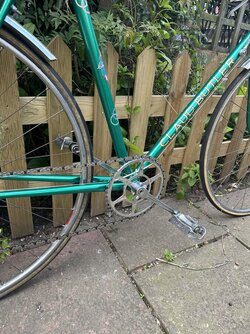

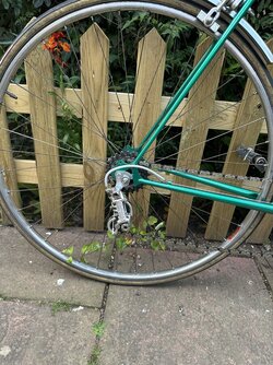

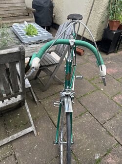

Well sourced a replacement Williams crankset and it fits!!
Bike now finished (apart from pedal dust caps) which I’ve ordered.
Maiden voyage awaiting - weather permitting. Thanks for all the feedback and advice. 😅

A lovely looking bike.
I've got to ask though, the stem, is it at it's height limit, it does look very high?
