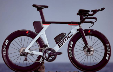

Ime (daughters and gear 'preference' as an excuse for not using 😢) this may actually be a shifter issue rather than a 'gosh two rings' issue. And the 'large' ring is 36t so with a CS-HG200-9, 11-36 should be good for all but the gnarly stuff. On the plus side daughter 1's weapon of choice is a BMC TT bike.
