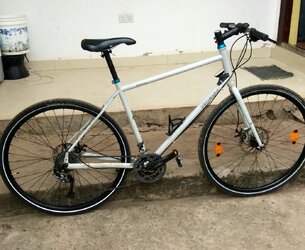

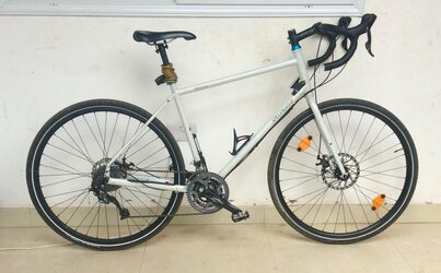

It's always a bit of a lottery doing this, sometimes it works sometimes not. As a rule of thumb if the bike has flat or drops as OE it's usually best left that way. This is a Specialized AWOL I converted to drops a few years back. I got it with flat bars but it originally had drops. Worked okay with flat probably due to the long wheelbase.
