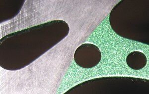

The disk is a green metalic paint, machined off the bearing surface. I was expecting a nicer anodised finish, of course it's not aluminium and you can't anodise steel! Pic 2.

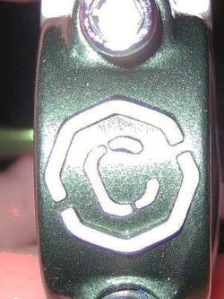

On the lever clamp, pic 6 and the cap on pic 3, the clarks logo is raised, and machined off after painting to give the metal to paint contrast. It looks quite nice.

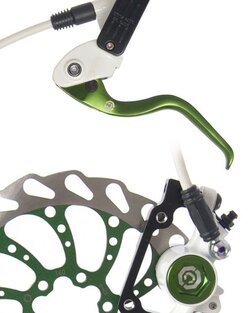

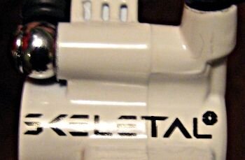

Pic 3 and 4 show the similarities to the RX brakes, ok the coloured RX plug, looks nicer close up than the clarks - all about money I guess.
To me, pic 5 shows the worst bit, you can see the casting marks where the moulds join, on any other I have seen, they have been removed, probably by hand? and that costs. Is it that bad though? and once fitted you don't notice unless you look close. There is also roughness on the edge of the machined surface where the bleed nipple fits.
Pic 6 shows the removable end cap on the lever, making it easy to remove without stripping the bars, and the logo makes it look great.
