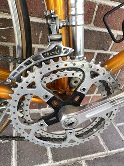

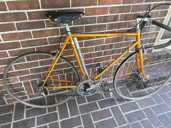

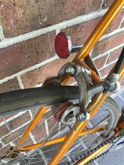

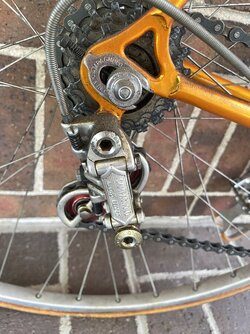

I live in Colorado in the US and help people downsize. This bike was pulled from a client's attic and I'm not familiar with the brand and cannot find any info on it's model or value. Based on my touring days - I'm guessing late 70s, early 80s. But does anyone know the model or its current market value?

Certainly a quality bike. Never heard of the name before. Your dates are about right. We're mostly Brits here.

A fine looking bike. I think it might even be a little earlier the given over bottom bracket gear cable guides, large flange Campagnolo Tipo hubs with the pre-1978 straight quick release levers. Is it 5 speed or 6 speed?
midlife
Nice :smile: mix of components from 70's stabby QR levers to later chainset. Over BB guides plus top tube cable guides but no portacatena probably puts it mid to late 70's frame.

Fairly sure that's an earlier nuovo record model. It has a bolt head top right, which is absent on the 1985 version. have a look at the 1976
https://www.disraeligears.co.uk/site/campagnolo_nuovo_record_1020a_patent-76_derailleur.html or 1974 incarnation
https://www.disraeligears.co.uk/site/campagnolo_nuovo_record_1020a_patent-74_derailleur.html
Edit: certainly a classy bike!
