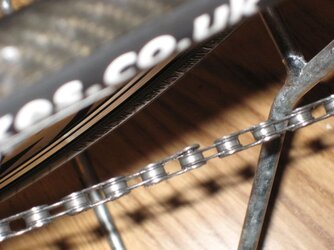

Not all KMC chains are good! This is one of their most expensive 10 speed ones after less than 200 miles. Fortunately I was alerted to the problem by the chain skipping, and thought the gears needed indexing. I didn't return the chain to the supplier as I had bought it 'on offer' almost 2 years before I fitted it. I replaced it with a Veloce chain, using a KMC link (Campag specific).
