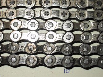

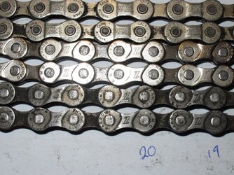

I thought I would have a bit of a play with my old chain and a brand new chain which is due to get fitted to my OH's bike later this week just to look at chain wear, lengths and compare measurements verses my chain checker. They are both KMC chains, for 7/8 speed bikes, but not the exact same model.
  • As near as I could tell, the new chain was a fraction under 25.4cm for 10 links.
  • My old chain came out at 25.6cm for 10 links: a growth of 2mm over the course of 10 links which makes it 0.8% longer when new.

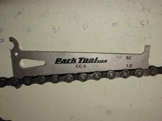

  • Both the 0.75% & the 1.0% parts of the chain checker easily fit into the chain but the chain checker is only checking over the course of 5 links not 10.
  • Meauring my chain tool, the 0.75% is 12.3cm in length exactly, 1% is a fraction over 12.3cm but not quite 12.35cm. So that would make 10 links on an imaginary chain checker as just under 25.7cm which would make a 1% increase.
  • But the chain tool has measure the old chain as 1% stretch over 5 links when it actually measures 25.6cm at 10 lengths stretched... a 1mm difference which does not sound much until you lay the chains out side my side and can actually see the difference.

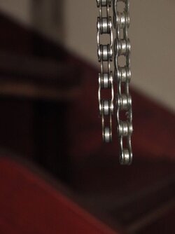

  • Hanging the 2 chains alongside each other makes it even more obvious over the course of the 52 links both chains.
So something is not as accurate as it could be but there is enough to let you know that your chain needs to be replaced using a chain tool which tbh saves time and dirty hands, plus the removal of a chain - I just don't think it can tell you that your cassette should also be replaced and I am dubious about the 0.75% mark as well for chain replacement. My old chain easily fits the 1% mark yet when I tested the new chain against the old cassette on every sprocket (having taken the rear wheel off) it was snug fit all the way around with no gaps at all (see one of the above posts for the link) and after a 45 mile ride I am more than happy that the cassette does not need replacing having used the granny gear on several long uphills with no skipping whatsoever - and I have worn out enough cassettes in the past to know when they do need replacing.
Confused - yep but also left wondering how the manufacturers of the tools can validate a 0.25% difference over 5 chain lengths when they are taking about a difference of 0.5mm at best and probably something like 0.3mm between 0.75% and 1.0%... but I will continue to use the chain tool as a guide not the "law" when it comes to replacing the chain &/or cassette.
