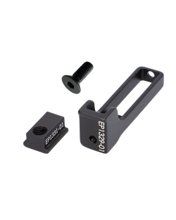

Does this look anything like the part required?
https://www.canyon.com/en-dk/gear/b...canyon-gp7228-01-belt-tensioner/10009129.html
