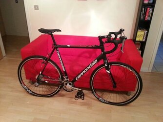

Pictures of said new bike...... Come on.
Thanks everyone
It's not new per say, I picked it up in Oct, but with my other issues, last week was the first time I rode it.
It's a 2013 caadx and as smokey says, the tyres turn you into a go anywhere nutter anyway, just before the spds were fitted and tyres inflated

Like the bike. I planned to buy one this year but ended up buying a 2012 CaadX 105 off eBay in January.
My plan is to get a second set of wheels to use for road only and keep the Sammy Slicks on the stock wheels. Having said that, the bike seems pretty quick with the 35mm tyres so I haven't bothered getting the second set yet.
