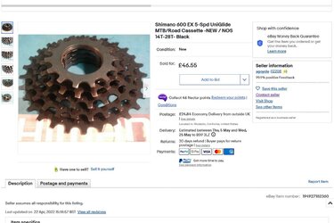

Thanks for everyone's help. I ordered the 5 speed UG cassette from States. Seller has also got some new 6 spd UG cassettes which is rare to find these days. However, although the same number of cogs as mine, they were twice the price of the 5 speed. Also the 6 speeds had different teeth counts to mine. As mentioned above, the new 5 speed cassette has the same teeth counts as the smallest 5 cogs on my old cassette, plus I can add my present largest cog from old cass, to the new cass - to make 6 speeds. My present largest cog gets zero use, so is virtually as new condition.
Pleased that I can cobble together a new 6 speed cassette for sensible money, because it's getting harder to run these old setups. And not being an expert, it means there's no conversion hassle to Hyperglide, etc - so I can do all the work myself.
